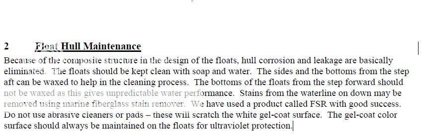

I've been running Aerocet 3500's for about 4 years now and I just read in one of their maintenance manuals that the bottoms of the floats should not be waxed - I believe it was a performance unpredictability issue.
Anyone ever heard of this before? I can't understand why a slippery float bottom would be a risk. Perhaps in a high speed taxi turn? Any thoughts on this?

This from the Service & MX Manual for the Aerocet 3500 Amphibs...

Some of the dry washes out there contain a sealant some do not. I have never worked on a plane or a vehicle with dry wash. People generally love everything that makes the surface shiny and causes water beads. In my book, the perfect sealant is what doesn't allow water or contaminants to stick around at all. Rinsing with water takes most of the dirt along and leaves a dry surface behind.
The instruction on not using any wax only applies to the bottom step forward part of the float. One would think that wax wouldn't have a long useful time, considering it is pressure washed on each landing and takeoff. Maybe we have someone here who's flown a waxed Aerocet float? Chances are they're still out there, skipping over the water uncontrollably... :?
